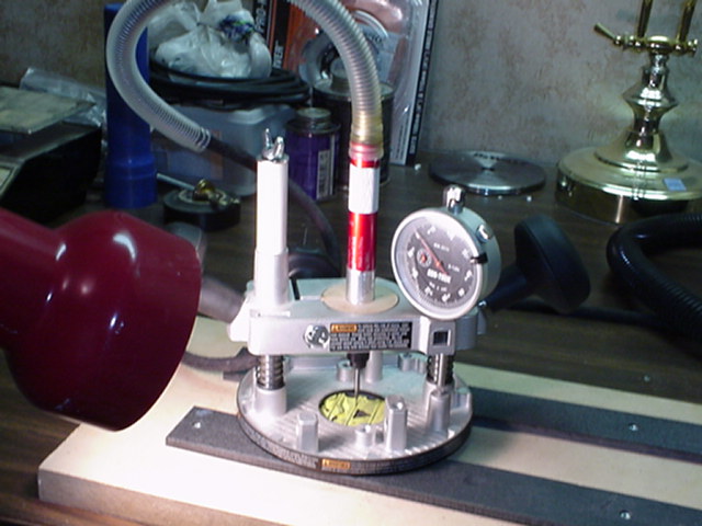

Jim, I use a rail setup made of a piece of mdf and some 1/4" thick plastic that was laying around. The fretboard wedges in nice and tight and stays flat while routing. I've done it the other way also, routing directly on the radiused fretboard, but it was harder to get a good fit for the inlay pieces.
I got my first 1/32 upcut spiral carbide bits from Dave Nichols, and since then have bought some USA-made Atrax brand stub end mills from industrial supplier Enco. They usually have them on sale at around $5 each.
Here's a pic of my router setup-with a short chunk of practice fretboard underneath. It's made from a Dremel Advantage cutout tool plunge base that I modified to hold a pencil grinder and a dial indicator. The indicator makes it very easy to adjust for the correct depth of cut, as not all your inlay pieces will be the same thickness. Best of all it doesn't cost much to throw one together- I spent $30 total to make this, because the plunge base was on sale at Big Lots really cheap and Harbor Freight has the other stuff on sale. It may look big and awkward, but I found it easier to use than the smaller bases. Visibility of the cutting area is good but getting lots of bright light down at the bit is important.
You're right about using the highest RPM setting on the Dremel, you'll get a smoother and more controllable cut that way. buddy lee38870.1428587963
PostPosted: Fri Jun 02, 2006 5:27 am
Buddy, I really like that jig. If your board is already radiused, no problem as long as it's not over 1/4" thick. If it's more than 1/4" thick, you could use the jig and a bigger router to thickness it exactly! You could also make one rail adjustable to accomodate any fingerboard taper. Cool!
